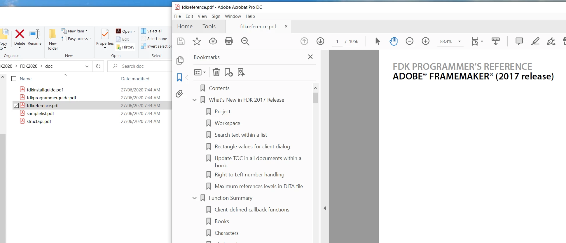

FDK for FrameMaker 2020 includes documentation for 2017 not 2020
I downloaded and installed the 2020 FDK to checkout some property defintions to see if there had been any change. Of course you always open the fdkreference.pdf to look there first. It was the 2017 document, not the 2020. In fact all 3 FDK documents are for 2017 (I compared them). The other two remain as 7 documents, which is another problem all together.
The .h files I checked, appear to be correct (#define FDK_LIBRARY_VERSION 0x16000000), so it looks like only the documentation is not 2020.

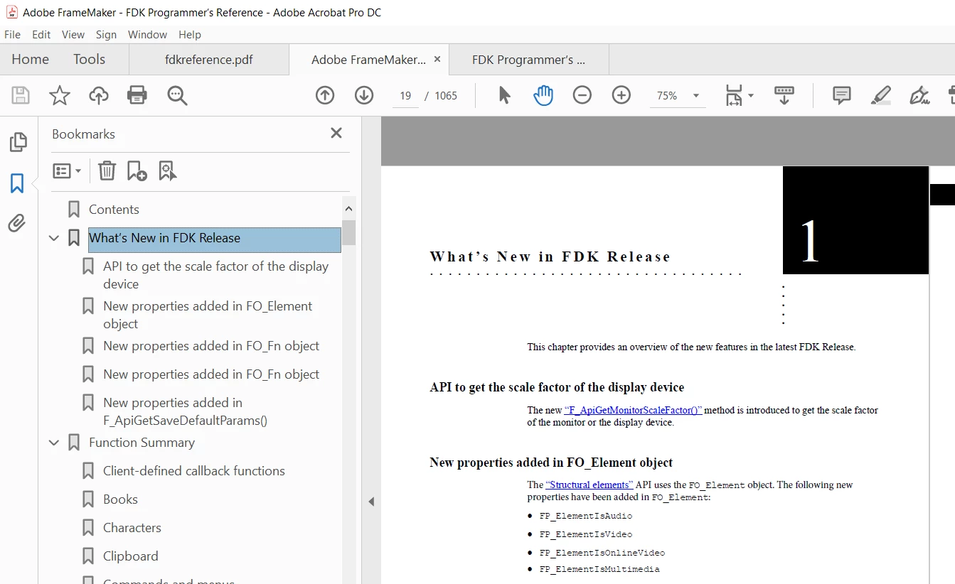

The Reference guide available at this link, The complete API reference , does appear to be for 2020, but, bizarrely, has no version reference!

I have attached two screenshots showing the 2017 reference from the 2020 FDK and the reference downloaded from the link above.
