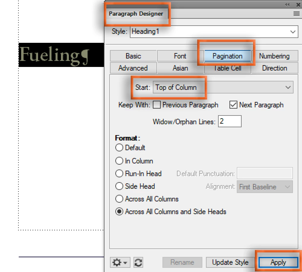

Hi Nathan:
Have you tried clicking in the subhead "Fueling" in FrameMaker, and applying a Top of Column to it, to force it to the top of the next page?  It looks like it was allowed to flow back to the previous page.
