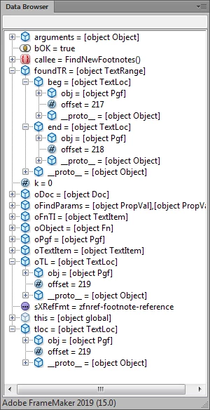

Dear friends with the sharp eyes and clear thoughts:
I'm puzzled. I have this piece of code (get the full script and the test document from here😞
  foundTR = oDoc.Find(tloc, oFindParams); // find footnote anchor (FN ref)
  while (foundTR.beg.obj.ObjectValid()) {
    oFnTI = oDoc.GetTextForRange (foundTR, Constants.FTI_FnAnchor);
    for (k = 0; k < oFnTI.length; k++) { // k always 0 nevertheless loop necessary!
      oTL   = oFnTI.obj.TextLoc;      // Location of the footnote anchor (beg)
$.writeln ("¶ format; FN ref: " + oTL.obj.Name +"; "+ oObject.FnAnchorString);
$.bp(true);
      if (CheckXRef (oDoc, oTL, sXRefFmt)) { // is there an XRef prior to FN anchor?
        tloc = oTL;
        tloc.offset += 2;                // behind the FN ref
        break; // continue;              // already an XRef inserted
      } else {
        $.writeln("\tNew FN found\n");
    oDoc.TextSelection = foundTR;        // DEBUG
I have text constructs like this:
  • Left to the cursor is a cross reference to the footnote; right to the cursor is the footnote anchor (FN ref).
  • Before I insert the XRef, tloc points to the FN reference.
  • After inserting the XRef and applying character format hypertext to the whole construct tloc points after the FN reference.
  • It turns out that the Find operation (line 16) does not start at this location but at the old location which of course is now more to the left.
  • Hence I'm stuck in a loop with finding the first occurrence of a footnote anchor.
Status of the Data Browser is when I am on line 17 of the above snippet:
  • It can be seen that oTL gets the same offset as tloc (assigning an object just creates an alias), but really cloning the object does not help.
  • Replacing break by continue (to run also the useless second iteration of the k-loop) does not have any influence, because oFnTI.length is always 1.
  • Nevertheless the k-loop is necessary: oFnTI[0].obj.TextLoc is an invalid object.
