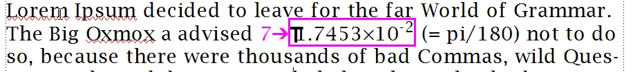

Dear friends and experts, I'm again at the end of my knowledge:
  • A variable just behind a marker is found and the variable can be deleted in the text
  • This variable should also be removed from the catalogue. I'ts name is not known, because the name is generated at the time of insertion (the current name is 2016-11-10T09:46:52.136Z).
  • Experiments with the text selection after finding the variable (line 31) did not reveal anything useful to get the name of the variable.
  • Do You have an idea?

BTW the marker contains this text: "C7 ¶ after T2 TB" = @Pi19_2 / 180.0; which is successfully evaluated and placed in the temporary variable - there is progress in my project¨.
