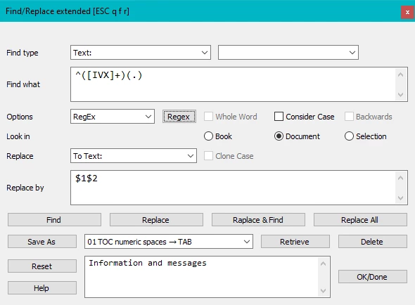

Barb Binder triggered my interest in creating an equivalent Find/Replace for FM (see here).
I have an idea of an UI which allows to insert Regex elements by selection from panel with drop down etc.. This shall be opened on click on the button RegEx:
BTW it seems that FM does not check the validity of a RegEx:
^([IVX]+)(.
does not create an error message if used for Find. FM just tells “Nothing found” The error is obvious: a mismatch in parentheses.
FM provides three flavours of RegEx syntax; Perl (the default), Grep and Egrep (enhanced Grep). There is a t least one significant difference betwee these flavours: handling of line breaks in the dot operator (any character). See the extensive discussion of this in the RegExBuddy by Jan Goyvaerts .
Therefore it is (for all but simple cases) necessary to know what is implemented (in FM. BTW ExtendScript Scripting guide and FDK reference / programmer’s guide do not know “Regular Expression” nor “regex”).
FM help tells about these flavours:
Perl: perldoc.perl.org, grep: www.robelle.com,  egrep www.gnu.org
The help text itself concentrates on the basic RegEx features which have equal syntax in all three flavours (and BTW contains errors).
With all these ambiguities I may end up with this solution:
My questions now:
  • What do you think about the whole idea?
  • Which RegEx flavour is really used by You?
  • Is it necessary to support all three flavours by the select/insert function mentioned before?
  • Which Versions of Perl, Grep or Egrep are implemented? FM help refers to the Boost library where a number of versiona are available.
  • Is it required that RegEx related information is localised? IMHO the linjgua franca in programming is English…

    IMHO for a selection this would be a preview of the result? Might be difficult, because I intend to use the Find/Replace mechanism of ES as I used it in various other scripts. The following are just snippings from such a script:
      findParams = GetFindParams (findString);    // Get the find parameters ... these will vary
      InitFA_errno ();                            // reset - it is write protected
      tr = targetDoc.Find(tr.beg, findParams);    // and do an initial find to get started.
      while(FA_errno === Constants.FE_Success && loopCounter++ < 2*loopMax) {
        targetDoc.TextSelection = tr;             // set up the TRto clear the original text
        targetDoc.Clear(0);                       // clear it
        app.ActiveDoc = sourceDoc;                // switch to sourceDoc
        sourceDoc.TextSelection = trReplace;      // to be able to get the replacement text
        sourceDoc.Copy(0);
        app.ActiveDoc = targetDoc;                // switch to targetDoc
        targetDoc.Paste(0);                       // and paste the replacement text
        ReApplyFontAndSize (targetDoc,            // re-apply the current para format
        if(FA_errno === Constants.FE_Success) {  // increment our return counter - does not work
          replacementCounter++;
        InitFA_errno ();                          // used to track the progress of the f/r
        tr = targetDoc.Find(tr.beg, findParams);  // something screwy happened ...
    But I'm just at the beginning of 'punchinging the fog'.
