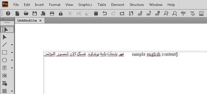

ok, oPgf.Language returns hyphenation language right?
in clear,
oPgf.Language returns 1(English) for arabic content also..
in above document how to i find arabic content and english content
