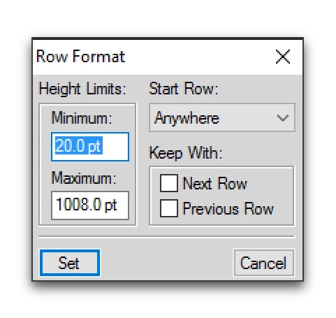

Is there an easy way to control the height of a table cell? Is there a combination of keys that will let me move the bottom margin up or down, or make it expand only as far as the last text line?

    By default, the row height expands with the content.
    Use Table > Format > Row Height to set a minimum and maximum row height for selected rows:
    Keep in mind that you have control over cell margins for the table in Table Designer > Basic properties, and by paragraph tag via Paragraph Designer > Table Cell properties. These margins may be helpful in getting the look are are after as well.

    That worked, thanx so much!

    Thanks for your reply. I know that's how it's supposed to work but my problem is that I'm trying to import a load (100+) of technical specifications that were produced using In-Design [MAC] into FM2017 [PC]. The best way I've found to do this to reserve most of the original table formatting is by using Word as a transition step. This import method works pretty well except that the row height no longer expands with content; and having looked at the Row Format dialog it appears that the imported data has somehow reset the default maximum row height to 0.52 cm!!
    So adjusting the paragraph before/after space and table padding has no effect at all.
    I generated a new 'clean' table template based on the one that I imported the data into and then applied the new template to the table but that didn't fix the problem.
    My current 'work-around' is to select all the cells in the table and change the maximum height (to something like 6cm), which seems to work. But I have literally hundreds of these tables to import and format over the next few weeks and I could do without this additional work overhead.
    Is there a way of switching the row auto-sizing off/on anywhere that you know of? Or a process to import from In-Design that avoids the problem?

    Sounds like a process that could be scripted - there are some scripting gurus that you could reach out to on the forums - do a search on scripting & you should get some hits.
