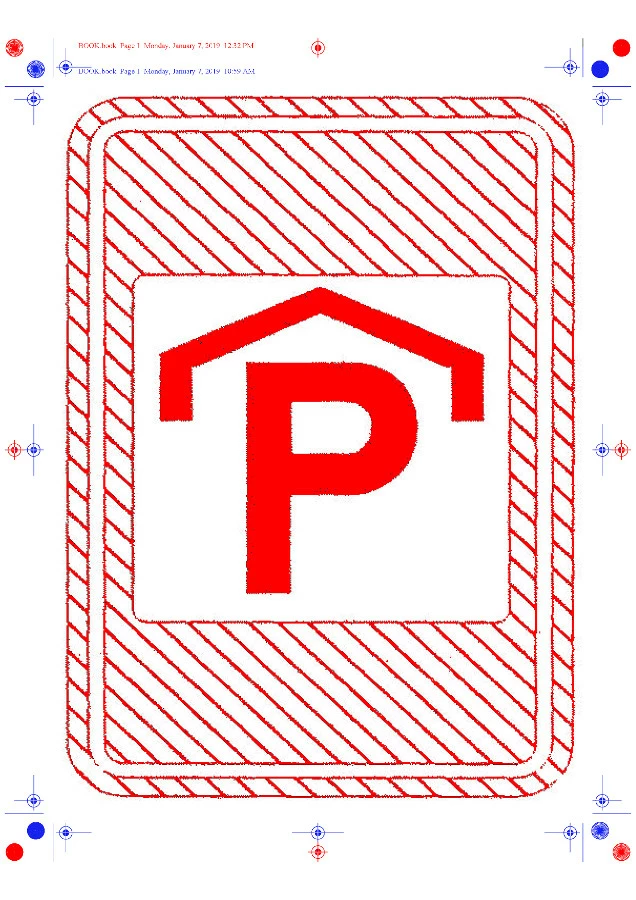

I'm using FM 12 and testing FM 2019 (version 15.0.2.503).
I'm worried about the result obtained when regenating my PDF.
In FM 2019, the registration marks aren't at the same place as in FM 12 (both image are same size)

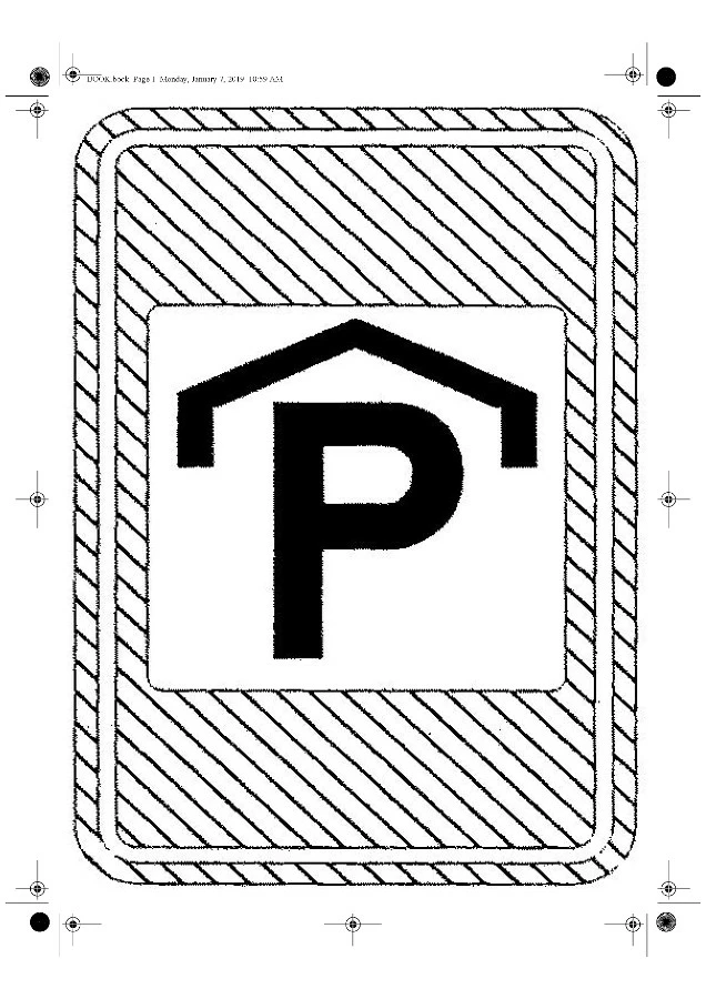

In FM 2019, i have the registration "bullet" but the crops makrs disappears [I tried print to AdobePdf, in .ps and with Publish menu (the last one is worst, no marks are shown]
Anyone know why isn't the same ?
The source file is a 175mm x 240mm size, the PDF generated is a 210mm x 297mm (A4)
At the end of my post, you will find and image where i merge both version :
In blue is FM12 version
In red is FM2019 version
FM 12FM 2019
    Pinpin PhilippeCorrect answer

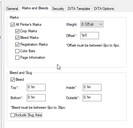

    @philippep2776167​
    You may not have to select the distiller option. In the PDF option simply try with these
    In General: uncheck all check boxes and use Print option and specify page size
    In Marks and bleeds
    please try and generate the pdf with these options and let us know if this works correctly. if any issue, you could share details with me at amitosin@adobe.com so we can look at other issues you are facing in regards to print settings for PDF.

    Amitosin, when I change the Publish Setting as your screen [by the way, 1p0 dont work, it's 1pc (internationnal English intallation-> UkEnglish, don't know if it's change sometings, but had some bad issue when using other language on previous FM version], I haven't marks on the PDF (but my page is 1.4cm larger and higher).
