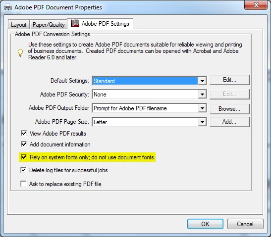

    When generating a PDF, what do your PDF settings look like? If you have the "Rely on system fonts only" option selected (see screenshot), you probably do not have the font in question (HelveticaNeueLTStd-Bdlt) installed on your system.
    If you are not relying on system fonts (this option is unchecked, which I don't believe is good practice), the font might not be available in FM. I don't know what version of FM you're running, but in FM10, you could try opening your file, and go to View > Pods > Fonts to display all fonts that are currently being used in your document and all instances of each font. Usually all missing fonts are replaced with "Times New Roman", so you can use the font pod to replace those instances with the correct font (if available in FM. Check Format > Font to see what fonts are available).
    I would definitely double-check that the font you need is actually installed on your system. I ran into the same problem, and that was my issue.

    October 31, 2013
    I figured it out. I changed my print option to pdf only, and deselected
    the font option. I was able to save as a pdf then.
