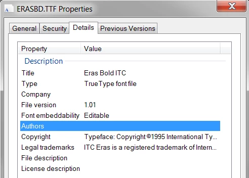

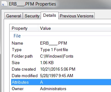

The fonts were stored on our network in a PSFONTS folder, with file dates going back to 1996!
Here's what I have in c:\windows\fonts:
If I click on the Eras Medium font, I see 2 items in the Font family details: Eras Medium Bold Italic and Eras Medium Italic.
The properties for the Bold Italic one show this:
If I click on the Eras ITC font, I see 4 versions in the Font family details window: Bold, Demi, Light, Medium. Clicking the Properties for the Bold font, I get this:
I know very little about fonts and what is going on here --why is there a True Type font and Type 1 font.
Thanks for any help you can offer.
-Debbie
Jan 19, 2017 8:18 AM UTC
Obviously you have two versions of this font, PostScript (PFB/PFM) and TrueType.
Probably this is not what you want.
Do your formats use both types?
Maybe you should use only TrueType or OpenType.
PostScript is used less now.
Which fonts did you send to your colleague?
Ask her to send you a list of the files in her font folder.
Many fonts have characters for Regular and Bold, e.g. Arial.
Other fonts have only characters for one angle or weight.
Fonts styles of a common font family are often connected.
This means when you select Bold, the font switches to the Bold style font.
Bolded means that the Bold impression is created by thickening the single lines of a character.
Anyway, now just import the paragraph formats from a good file and select Remove Other Format/Layout Overrides.
Or, if you have overrides which you want to keep, select one of the heading paragraphs, correct the font and click Update All.
Then repeat this for all your different heading formats.
