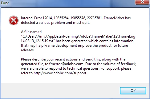

February 13, 2014
Hi Colin,
I just confirmed this in unstructured mode as well. Adding the UserString with a value to any table and then trying any of the Publish modes results in:
I'm wondering if the UserString attached to other objects could also trigger a crash.
