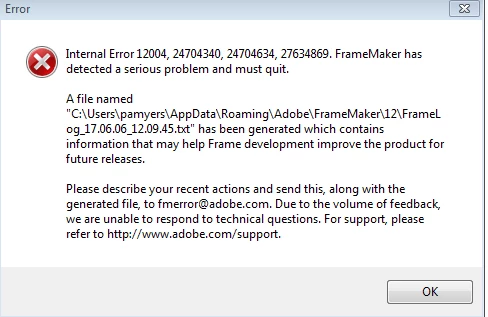

When I double-click a file to open it directly, Framemaker reports the following error.

do you auto-run any scripts?
It seems to me, that anything (a script in your startup folder)  switched display to off.
If you are familiar with scripts, you could start the ExtendScript Toolkit (ESTK) type in these lines or copy/paste and run it.
alert("Display : " +  app.Displaying);
if (app.Displaying == 0)
   app.Displaying = 1;
If Displaying is off it will show you "Display : 0" and switch it on.
ESTK can be found here: C:\Program Files (x86)\Adobe\Adobe ExtendScript Toolkit CC\ExtendScript Toolkit.exe
