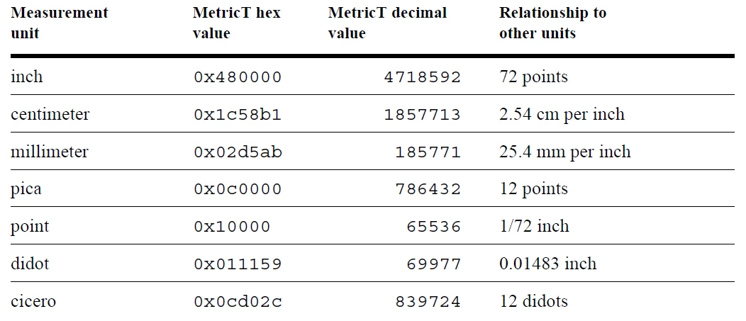

The thing about these height and width properties (among many other object properties in the object model) is that they use these "metric" units. It is a little tough to understand at first and maybe you don't really need to understand it fully. All you need is the proper conversion factor. To convert from metrics to millimeters, set the properties like this:
doc.PDFPageHeight = 297 * 185771;
doc.PDFPageWidth = 210 * 185771;
In other words, to convert from millimeters, multiply by 185771. This works in ExtendScript because the property is expressed as decimal integer. Below is an excerpt from the FDK manual that provides other conversion factors. Hope this helps some.
Russ
Using MetricT values for linear measurements
When used for linear measurement, a MetricT unit represents a point (1/72 inch). The
16 most significant bits of a MetricT value represent the digits before the decimal;
the 16 least significant bits represent the digits after the decimal. Therefore, 1 point is
expressed as hexadecimal 0x10000 or decimal 65536.
The following table lists the units of the measurement systems FrameMaker products
support and their MetricT equivalents.
Russ
