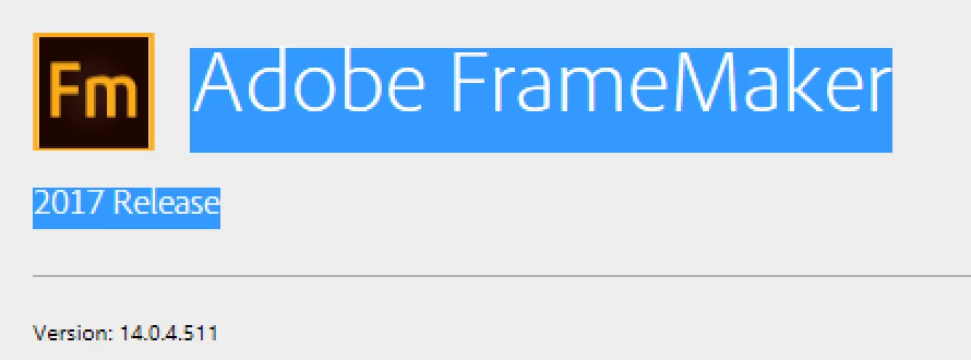

    Current version is 14.0.4.511
    You can get details of the improvements in each patch release at
    http://techcommtools.com/?s=update
    -Matt
