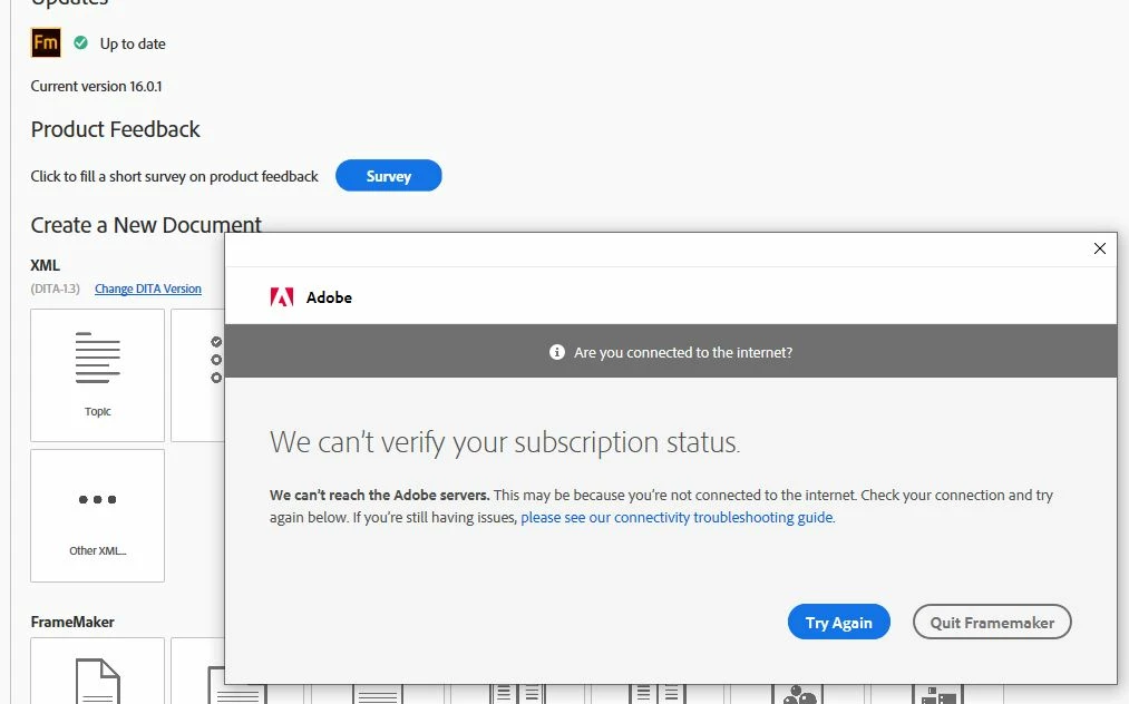

    Almtuna
    June 21, 2022
    This is what I got when starting FM after disconnecting the Wifi.
    June 21, 2022
    Thank you for testing this and posting your feedback, Almtuna.
