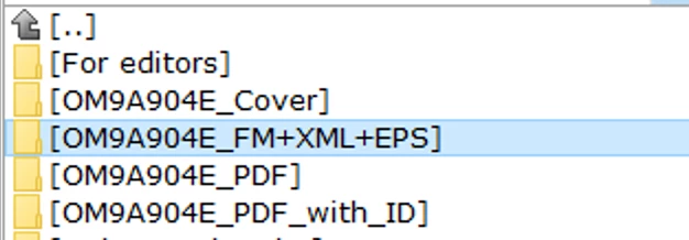

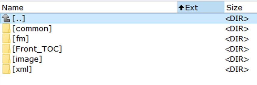

This is what the client sends us (screenshots attached). I don't know why translators ask for a XML file, but that's their requirement. On the other hand, we have a big problem with KLIF files, I posted in another discussion - 14126824

What is the relationship between the FrameMaker files and the XML files? Do they contain the same content?
Are the FrameMaker files structured FrameMaker files? Do they "load" the XML files into templates? We will need more information from you to get a better idea.
