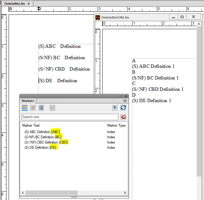

    You’ve been such a tremendous help. I continue to test with no resolve.
    My apologies I’m not sure I’m explaining the problem correctly.
    I have acronyms that are classified (S) and (S//NF). When I index them they list all the (S) acronyms alphabetically and all the (S//NF) acronyms alphabetically. I need the list integrated (all together). I need the list generated ignoring the (S) or (S//NF) at the beginning and alphabetizing the acronym following the classification.
    This is what I’m looking for:
            (S) ABC    Definition
            (S/NF) BC    Definition
            (S//NF) CBD    Definition
            (S) DE    Definition
    Not like:
            (S) ABC    Definition
            (S) DE    Definition
    You can change the way index entries sort by putting a sort value in square brackets at the end of the marker text:
