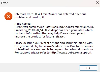

    Sep 28, 2026 7:02 PM UTC
    This is the error I'm getting. No messages on the console. I can properly open the MIF file in programs like Notepad++ and I can see the translated text just fine, but I'm not sure what the problem is.
