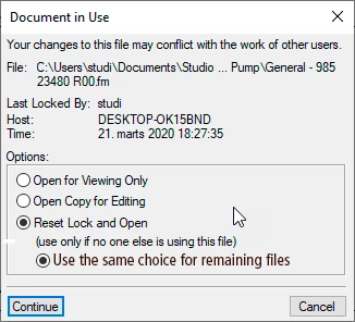

    I created this feature suggestion a couple of years ago:
    https://tracker.adobe.com/#/view/FRMAKER-10853
    Make it possible to delete all lock files in the manner which Windows handles repeated actions. As of now you have to press "Reset Lock and Open" on every single file, or delete the lock files using Explorer.
    Bjørn Smalbro - FrameMaker.dk
