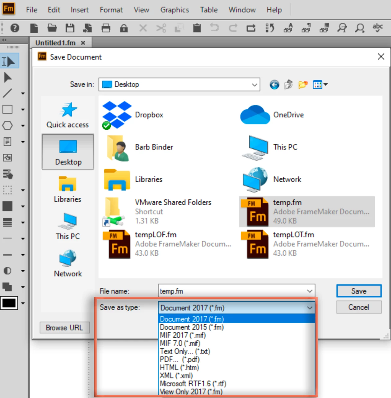

Oct 9, 2019 2:27 AM UTC
Hi PrairieMarie: Did you check the Save as Type menu at the bottom of the dialog box? The File > Save as command can be used to save .fm files, .pdf files and others, depending on what is selected in the menu. Be sure it is set to Document (2017) (.fm).
~Barb
Oct 9, 2019 1:19 PM UTC
Hi Barb. Yes, I'm definitely saving as .fm. But when I go to the folder to find the document, it appears as a .PDF !
