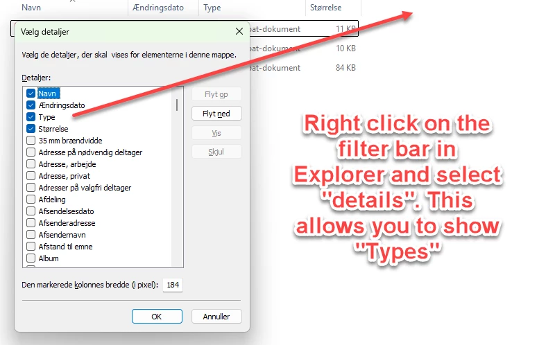

"1) At start, it says "At least one original filter used for graphics is not available......"
How can I find what graphic is missing or bad?"
Try going to the folder where you store your graphics. Sort the folder by file type. If you have files of the type *.tif, *.tiff, *.bmp - they may be likely culprits, and you can try converting these file to *.png and relink them.
Regarding the document and the hanging problem... Is it ONE big fm file or is it a book with multiple chapters?
Bjørn Smalbro - FrameMaker.dk
