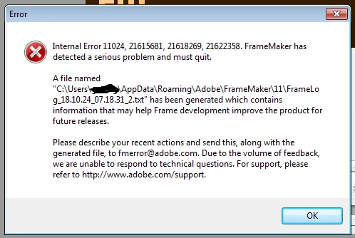

I developed a script to automate the generation of large FrameMaker books from Ditamap and XML files.  The script successfully generates 2 or 3 of these large books before FrameMaker crashes midway through the book generation with the following error message:
The point at which FrameMaker crashes appears to be totally random and the internal error code often changes as well.  Some research on these forms led me to believe that it was due to saving the book to a network drive, so I modified the script to save to my C: drive and the crashes got WORSE!  My FrameMaker 11 is patched to the latest version and I've got 50 gigs of free space on my drive.

frameexpert
Oct 24, 2018 9:14 PM UTC
FrameMaker may just be leaking out memory on big process like this. You may want to try downloading and installing a trial of the 64-bit version of FrameMaker 2019. You should be able to install it side-by-side with FrameMaker 11.
