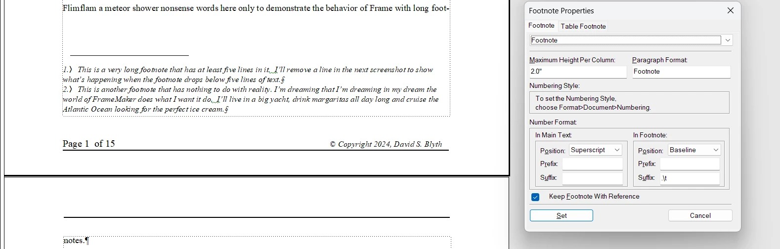

    17.04.628.  I just downloaded the most recent rev a few days ago.  FYI, the ruler shows that the gap is 3/4".  Plenty of space to add a few lines before hitting the footnotes.
    And what's the setting for
    Format 🞃 Document » Footnote Properties… /Footnote\
    Maximum Height Per Column
    See attached screenshots.  I also tried changing the widow/orphan settings of the involved tag (I'm currently in unstructured mode) with no effect.  That is, I fussed with the widow/orphen settings of the "body" tag, not the "footnote" tag.
