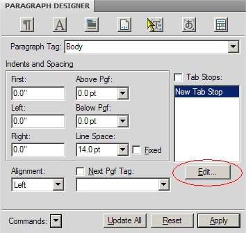

    1. In your paragraph designer, you should see this:
    Click on the marked Edit button.

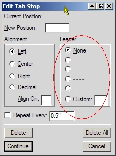

    You will then see this:
    This lets you define where the tab stop is located, what type to use and what kind of leader it should have.
    When you have made the edits to the respective TOC paratag(s), press the Update All button shown in the first panel. This will set your changes permanently into the TOC file.
