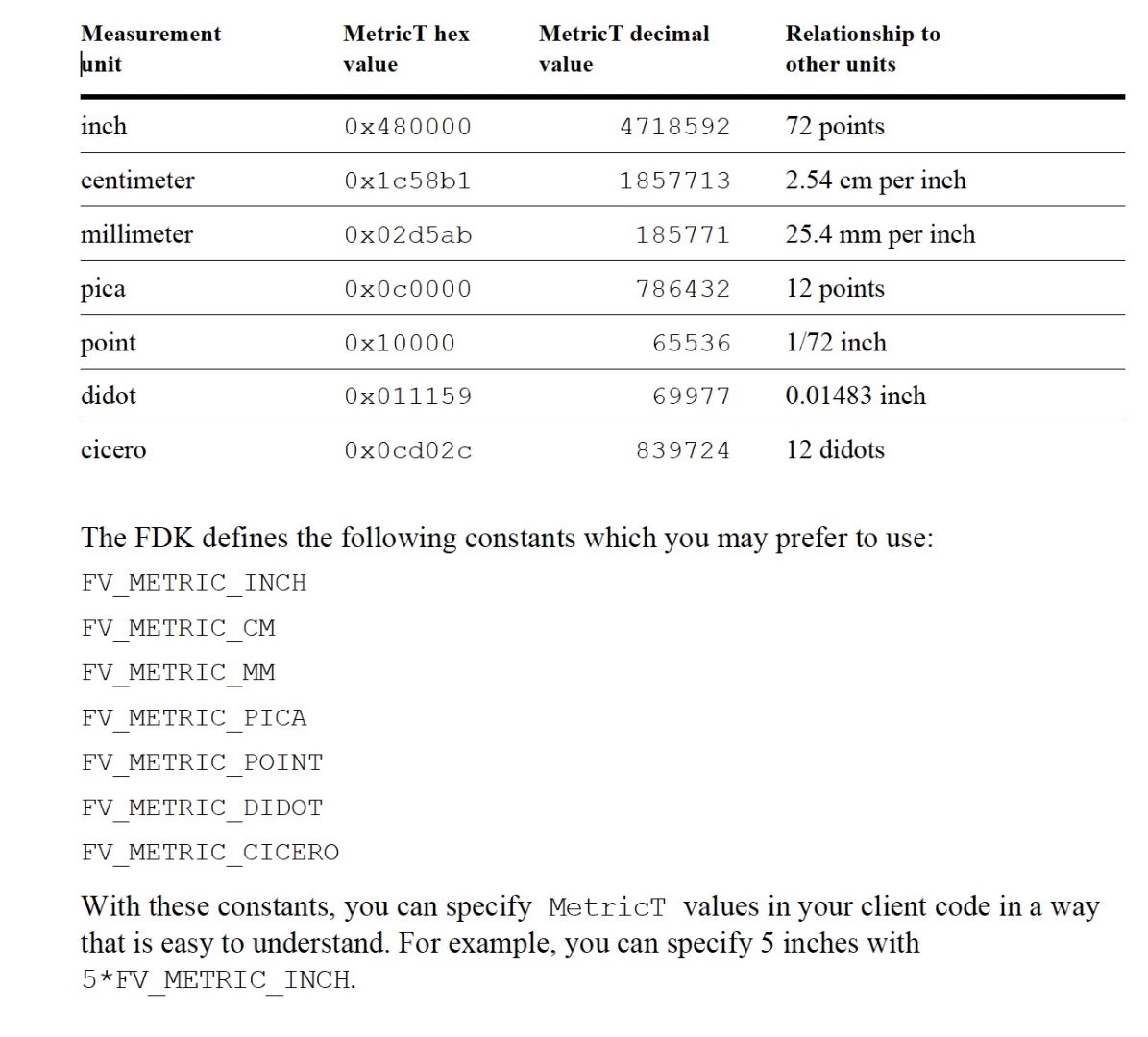

4everJang
Feb 26, 2019 10:53 AM UTC
Use oProp.propVal.val instead. And note that all sizes in Fm are expressed in Metrics. For a full conversion table from Metrics to other measurement units, here is the page in the FDK Reference Guide you can use:
