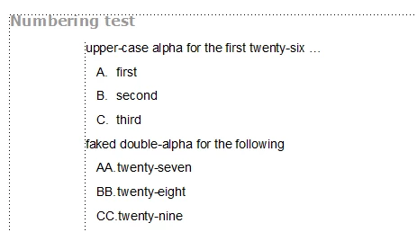

As politicians traditionally say, "I'm glad you asked me that question!" But I truly am, because it got my brain started … and I do believe I may have found a possible answer for you. Here's the result:
The first list uses H:< ><A+>< >.\t (based on existing styles in the first document I reached for)
The paragraph "faked double-alpha …" uses H:< =0>< =0>< =0> to reset the counters
The second list uses H:<A+><A+>< >.\t (not entirely logical, but <A+><A> returns A zero)
Of course, this probably isn't an exact match for your client's extraordinary requirement :-} For a continuous list, you might end up needing three styles: A-Z, first AA, subsequent BB. By the way, what comes after ZZ?

I apologize for dropping this question here and then disappearing: The project that prompted the question quickly turned into an all-consuming nightmare. (That could never happen to an editor, right?)
In the press of time, I was forced to resort to the aforementioned Brute Force and Ignorance™ solution, which was not exactly the same as yours, but similarly involved using multiple counters to imitate a "two-digit" alpha label. I had been hoping there was a way to change the default behavior of the <A+> counter for values >26 (apparently, AA, BB, CC... is the default scheme in Word, and my internal customer was demanding that I emulate the numbering scheme of his customer's requirements document... which was created in Word, because Word is the hammer everybody has, making every document a frickin' nail... but I digress....). The moment has passed, though, and I profoundly hope I never need to wonder about this again!
