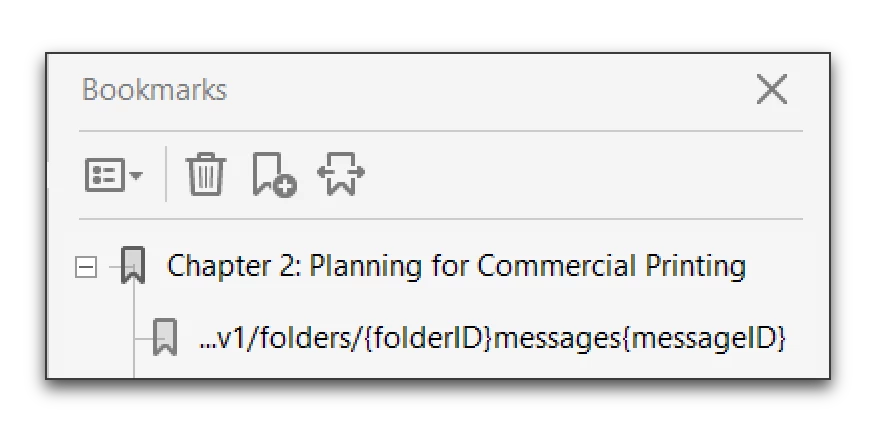

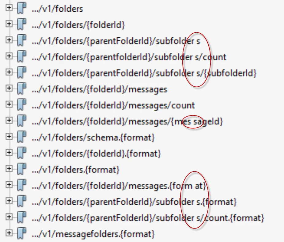

Headings in bookmarks contain unexpected blank space
See the snapshot below.
The space where the blankspace is inserted, is the point where the heading text wraps in the FM editor. How can I eliminate this space in the bookmarks?

Jun 20, 2017 3:20 PM UTC
First: Which FM version are you using? I have blurry memories that this effect happened in some very, very old FM version (like FM 6 or so). I tried to reproduce this in FM 2017 and did not get any such additional blanks in bookmarks.
This is strange. FrameMaker usually does not wrap in the middle of the word (like in "subfolder s"). Have you inserted manual breaks in FM like with Shift-Return? Shift Returns in headings are translated into spaces in PDF bookmarks.

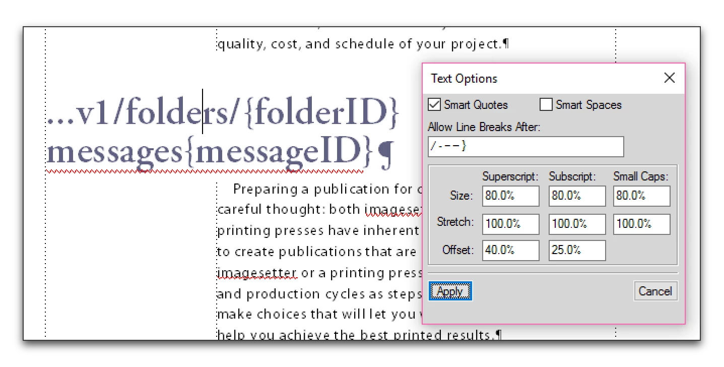

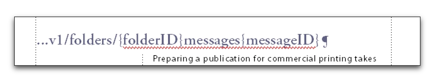

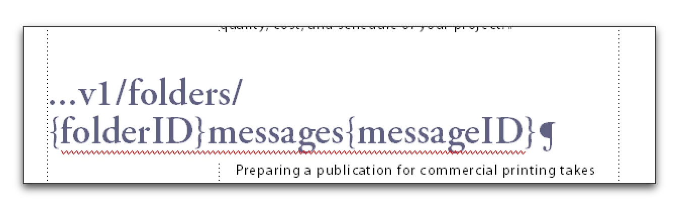

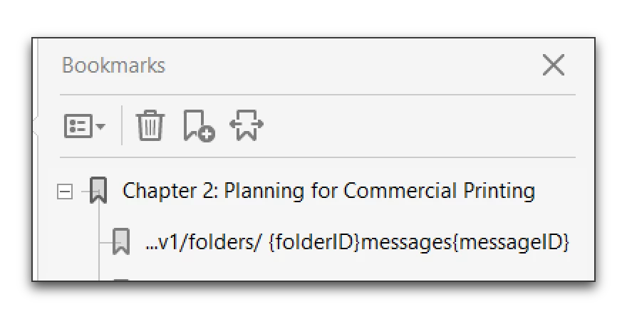

I'm very curious to see if you can make some headway here, Stefan, but just as a heads up, I got the same results in 2017 with Acrobat Pro DC.
In these screen shots, the only difference is the type size. I didn't make any changes at all on any break settings—text options dialog box, line breaks, or spaces.
Jun 20, 2017 3:57 PM UTC
I see. I have tried it in the same way now and rebuild a doc like yours with a "...v1/folders/{folderID}messages{messageID}" heading with a line break just after "folders/" like in you example.
When I print to PS and analyze the code, this bookmark for this heading is produced like this:
[/Dest/G998522/Title<FEFF002E002E002E00760031002F0066006F006C0064006500720073002F0020007B0066006F006C00640065007200490044007D006D0065007300730061006700650073007B006D00650073007300610067006500490044007D>/OUT FmPD2
So, the line wrap is actually translated into a simple space (0020).
I'll check with the devs and will suggest fixing this in the next release.

Jun 20, 2017 2:31 PM UTC
Yes, it certainly does. I played around with this for a while, ericy83354268, and don't have a good solution for you. When you think of "normal" headings, they have spaces in the between the words, and FrameMaker knows how to transfer them correctly to the bookmarks.
Your heads don't have spaces, and Fm seems determined to add one in the following situations:
  • at the text wrap location
  • at a line break/soft return location
  • even when you change Text Options to Allow Line Breaks After to include a close brace character } (which I was sure was going to be the solution)
The only solution I see is to edit the bookmarks in Acrobat (not a good one!), and report this to Adobe here: Tracker.
