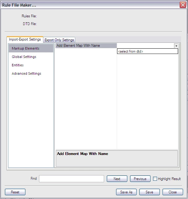

Once I get the DTD, I’ve been trying to use the Structured Application Designer to generate the RW Rules.
I select Add Element Map With Name > dtd. When the list of elements appears, I select all of them and add them to the Import-Export Settings and Save the new Structured Application; however, this does not seem to have any impact on the files I’m trying to structure and save as xml.

The Structured Application Designer is for creating your own structured application .. you should likely just be using the provided DITA structure applications. If you want to customize those that's fine, but that should probably be done after you've converted your content.
To be honest, I have no idea how to use the Structured Application Designer .. I've been creating structured applications for years the old fashioned way, and find this too to be very confusing and overly complicated. Unfortunately there's very little useful documentation (that I'm aware of) on this tool so that complicates matters. You should really read the Structure Application Developer's Guide to get a full understanding of all the pieces that make up a structure application .. then you may have better luck with this tool .. or you'll just be able to create an app on your own.

The Structure Application Designer may be able to help with this, but I can't say.
2) In your cloned apps, modify the properties and styles in the template file to change the page layout and formatting. If you need to modify the underlying EDD, remember that the EDD lives inside of the template, so you'd modify the EDD then import that into the template. The structured application definition references the template file which is a combination of the EDD and template. It's likely that you won't need to touch the read/write rules .. this just affects the mapping of one element type to another or the assigning of object types to elements. Unless you're making very serious changes to the DITA structure, the default r/w rules file should be sufficient.
