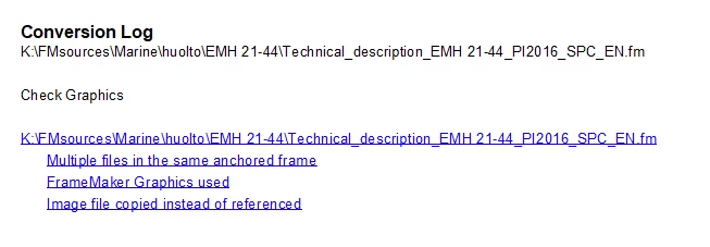

I have been automating a lot of tedious work for my clients since a long time. In many cases I needed to write an error report to inform the user of stuff they needed to correct in their FM files. I would like to do this in the same manner as the Error Log you get when updating an FM book and some problems occur (files not being opened, color settings that are inconsistent, unresolved cross-references etc.).
I check from a simple script and find that this error log is not a document, even though it does contain cross-references to the locations of errors (e.g. unresolved cross-references) in the checked documents. I would like to know a couple of things before I dig into this any further:
1. Is there a way to create this type of view from scripting ?
2. How do I enter text  into that view if it is not a Doc object ?
Of course if any of you have a sample script that they would like to share with me, that would be wonderful.

With the pointers from Rick and Klaus, I managed to adapt the BookErrorLog to do what I wanted it to do. It is, as Klaus indicated, simply a FrameMaker document which is opened from the fminit directory. And even though it is read-only, I can still make changes to it via scripting. So now my conversion log has exactly that title, and all issues that were found are hyperlinked to the location where they were found.
