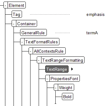

This is an easy fix. The emphasis element must be defined as a text range. It will then work as you expect. Also because you have a nested termA element that too must be a text range. In the edd it will look like this:
The read/write rule that you mention plays no part in the display of text in a structured FrameMaker document. Its purpose is to define the maximum line length for the XML files that FrameMaker creates.

Thank you so much Ian!!!
I edited EDD as you showed me kindly and it worked!!!
