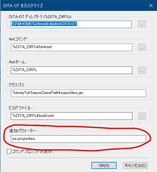

Hello all!
Is there a way to specify a .properties file to use when processing DITA content with the DITA-OT? A .properties file can contain information about how to process the DITA data, such as including custom CSS files, headers and footers.
I thought it might be this last text box in the DITA-OT Customize dialog. (Sorry I'm working in a Japanese environment, but the last text box is "Additional parameters".
I tried entering "--propertyfile=es.properties" which is what I use on the command line with the standard 'dita' command. However, nothing is output.
I tried "es.properties", but then I get a build error:
BUILD FAILED
Target "es.properties" does not exist in the project "DOST".
Since I can't see what command FrameMaker is using, it's near impossible to diagnose the problem. (I can see a flicker of a command prompt, but it disappears before I can see what it's doing...) And the documentation is no help either ("You can specify additional parameters"... THANKS!)
Any insights would be appreciated.
Cheers!
Michael

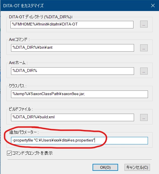

    Success!
    It turns out you can pass a property file via the "-propertyfile <file>" command line argument:
    Just specifying '-propertyfile es.properties' didn't work; the program isn't looking in the directory where the DITA files are, so I had to specify an absolute path.

    Set the Build file field to point to this file worked.
    I hope this helps anyone else having the same problem!
