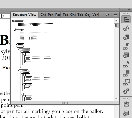

How can I zoom the structure view?
After years of using FrameMaker, suddenly I get this. It still works, but it's too small to read. I fear I have somehow inadvertently changed a setting someplace, and can't find where. How do I make it big again? Sorry if this should be obvious.

Hello Jack,
This caught me out too. In FM 2017 the single main zoom control affects the structure view  too, but only when the structure view has the focus. It takes some getting used to but seems to work just as well.

Bless you once again, Ian.
Got it. I thought I had tried that idea, but I see that when I tried it before, the structure view was visible but didn't have the focus.
