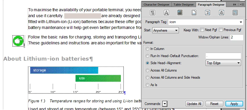

July 18, 2016
fwiw, here's how I deal with it … sideheads help headings stand out for easy navigation, and I don't get beaten up for using tables for layout :-}

July 18, 2016
re: …sideheads help headings stand out for easy navigation, and I don't get beaten up for using tables for layout :-}
Well, the OP did indicate awareness of both the SH and TBL approaches, and wanted something else. Of course, we still don't know precisely what is desired from a layout, workflow and stewardship standpoint. Any of the 4 techniques discussed so far would be fine for print and PDF workflows.
HTML, XML and eBook workflows have different considerations, and would require testing.
For example, I have no idea how FM flows SH layouts to those paths, and tables could result in something that doesn't scroll smoothly, and may not be treated as part of the main flow for copy or print-selection. The anchored frame technique requires careful selection of graphic object format.
Icon-as-custom-font has workflow issues as well, due to being a non-standard font that would have to be embedded and/or assured-available as a web font.
