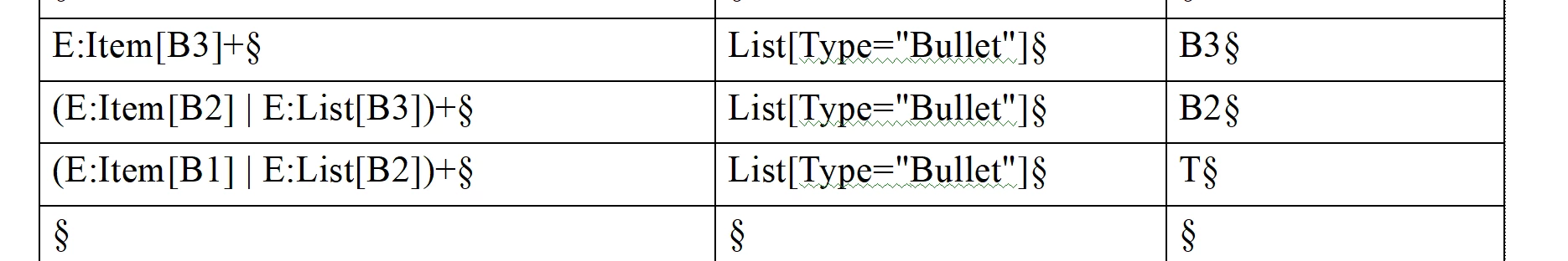

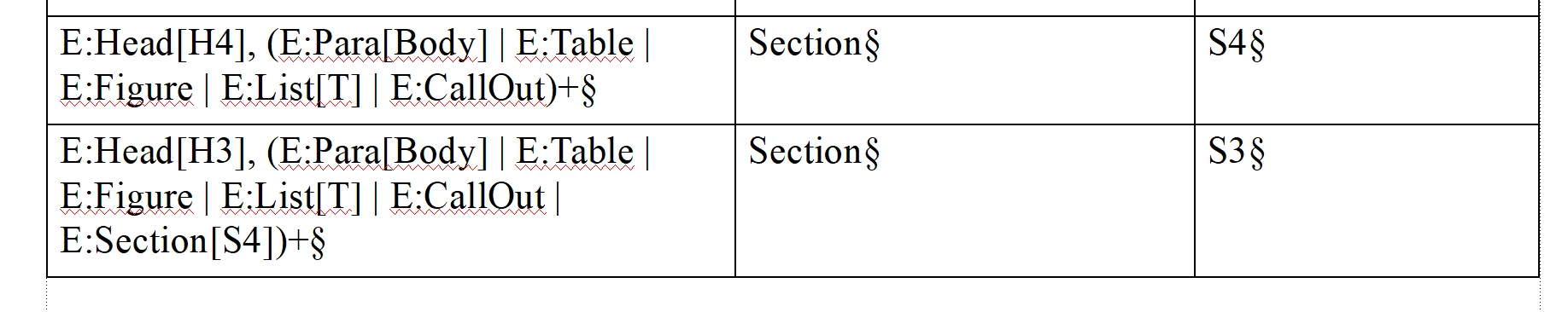

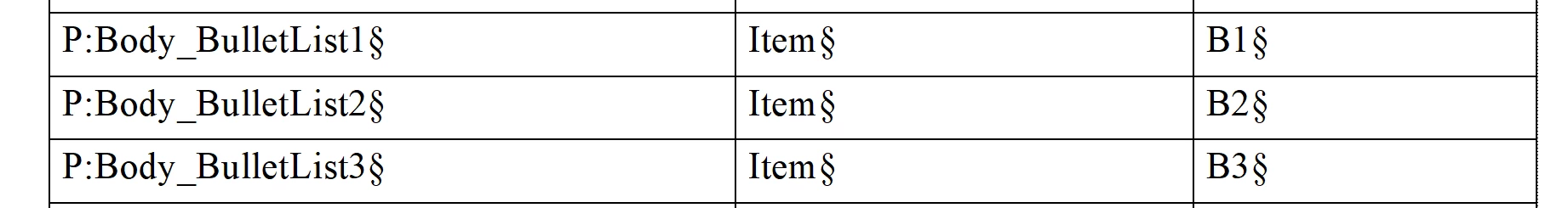

    Here is how I do it. Keep in mind that formatting differences may affect your inclusion in Sections.
