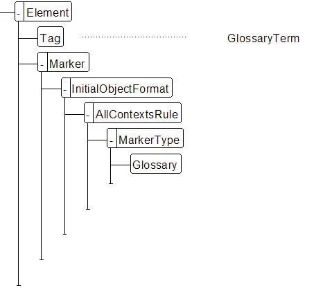

I'm stumped.  I can't figure out how to go from having a EDD marker entry for a glossary:
to actually having a Glossary?  I can tag terms with the Glossary marker and ask FM9 to generate a list of Glossary markers.  But how do I get it to only display one listing per term (i.e. "Name" page 2, 6, 24 & 32 rather than "Name" page 2, "Name" page 6, "Name" page 24, etc.?)  And how do I add the definitions for the terms?
I can't figure out the process of building a Glossary at all, so I'd really appreciate some guidance!

A view at this help topic for Robohelp suggests that the intended use of FM's glossary markers is to prepare a glossary to be published in Robohelp.
Creating an index of markers rather than a list will do this, but this would result in more of, well, an index ...
I don't know of any built-in featue in FM that would allow to auto-generate a glossary. As you're using a structure application, it might be feasible to save as XML and generate a glossary outside FM.

However, I'm wondering now, what are the capabilities of the Glossary Marker type that can be built into the document?  Does it simply generate a list of the marked text and nothing more?  If so, then the method you describe Van would definitely be better.  It seems odd to me that the possibilities of the Glossary Marker aren't more robust (even if I can't figure them out) in being a tool to somewhat automate the construction of the structure above.  (If it's just a list, then it's really an index, not a glossary, right?)
To answer your question, I was trying to use Glossary Markers because the name would imply that they are the best practice way to implement a glossary!
