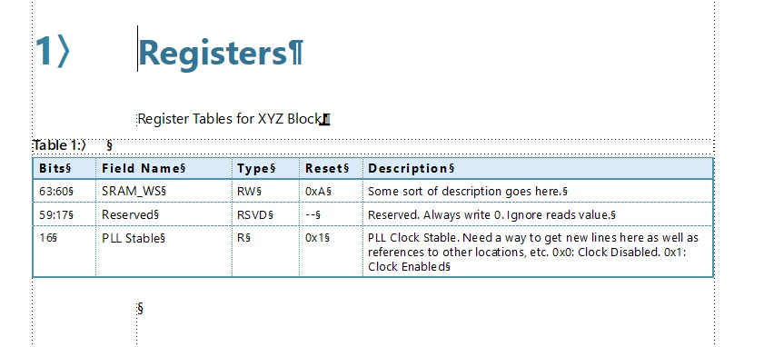

    My problem is that I would like to manually populate the numbered ParaTag: TableRegTitle - as you can see, it's populated in the MIF, but does not show in FM (see image).
    If you need the template file - then I'll have to email it - I cannot upload a MIF file to this forum, it's not supported.
    This is the result of the code below when opened in FM. Here, I've removed 2 of the body rows, so you should end up with a table  that has a single header row and a single body row.

    <String `Example Register1 Name (Ex_Reg1_SN)'> #this string is missing when opening in FM (see image)

    Hi oz1010,
    I tested this, but I also could not populate the table title with the text from the MIF file.
    I suggest to contact the FrameMaker support: tcssup@adobe.com
