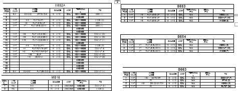

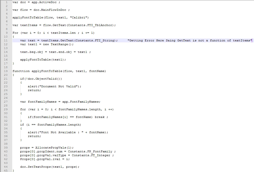

I have a Frame Maker document file which contain a imported Word file. The document contain lot of tables like below.
What i am trying to do is to create a ExtendScript which will loop through whole tables in the Main Flow of Document and change the FONT Style and TEXT Size of content inside the table.
Please help me to sort out this issue.

I suggest that you break this down into tasks, starting with the smallest and moving to the largest.
1) How do I apply changes the paragraph containing the insertion point?
2) How do I loop through all of the paragraphs in the selected cell?
3) How do I loop through all of the cells in the table?
4) How do I loop through all of the tables in the document's main flow? (This is where your current script is broken.)
As you test each task on a small level, you can be confident that it will work when you expand it to an entire table or document. Each task will be accomplished by one or more functions that you can chain together to form your finished script.
As Jang mentioned, some of us on the forum do this kind of work as our regular jobs, so we have to give priority to our paying clients. However, we like to help others. But it is easier to get help for smaller tasks.
That said, here is some code that will loop through all of the tables in the main flow of the document:
var textList, i, tbl;
// Get a list of all of the document's main flow tables.
textList = doc.MainFlowInDoc.GetText (Constants.FTI_TblAnchor);
for (i = 0; i < textList.length; i += 1) {
    // Get the Tbl object for the current table.
    tbl = textList.obj;
    // Call a function here to process this table.

I am importing a word document to an FM Template. After importing i will delete everything except tables (already done using Extend Script). So now i am having 100 of tables in my document.
The text size of the content inside the table is too small and font also has been changed. So i want to change the whole font type and text size of the text inside table.
Sorry to say, i tried what you suggested but no change has happened . Since i am new to FM i didnt understand how exactly the import format option will help me in resizing the table text.
