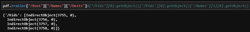

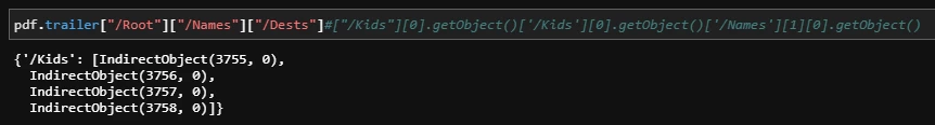

    However manually editing the links is not practical in my case. I need to automate fetching the cross reference ID/URI for over 1000 documents with 150-200 pages each. Now they are already in the cross reference format, meaning they don't have a URI link instead they have a destination mapping. According to the document structure explained by O'reilly, I need to find the '/Dests' which is supposed to hold the information about the cross references. But I am not able to find it when I fetch the data structure using popular python pdf manipulation libraries like pyPDF2.

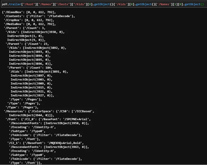

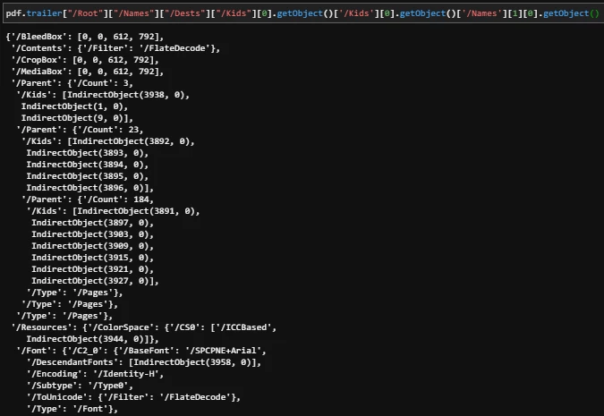

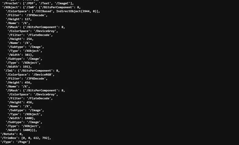

    The above is what '/Dests' hold and when I go deeper, I find this.
    I do not understand where the destination ids are and how the indirect object in one page is mapped/diverted to another indirect object in another page within the same pdf. Some clarity would help build/develop over it.
