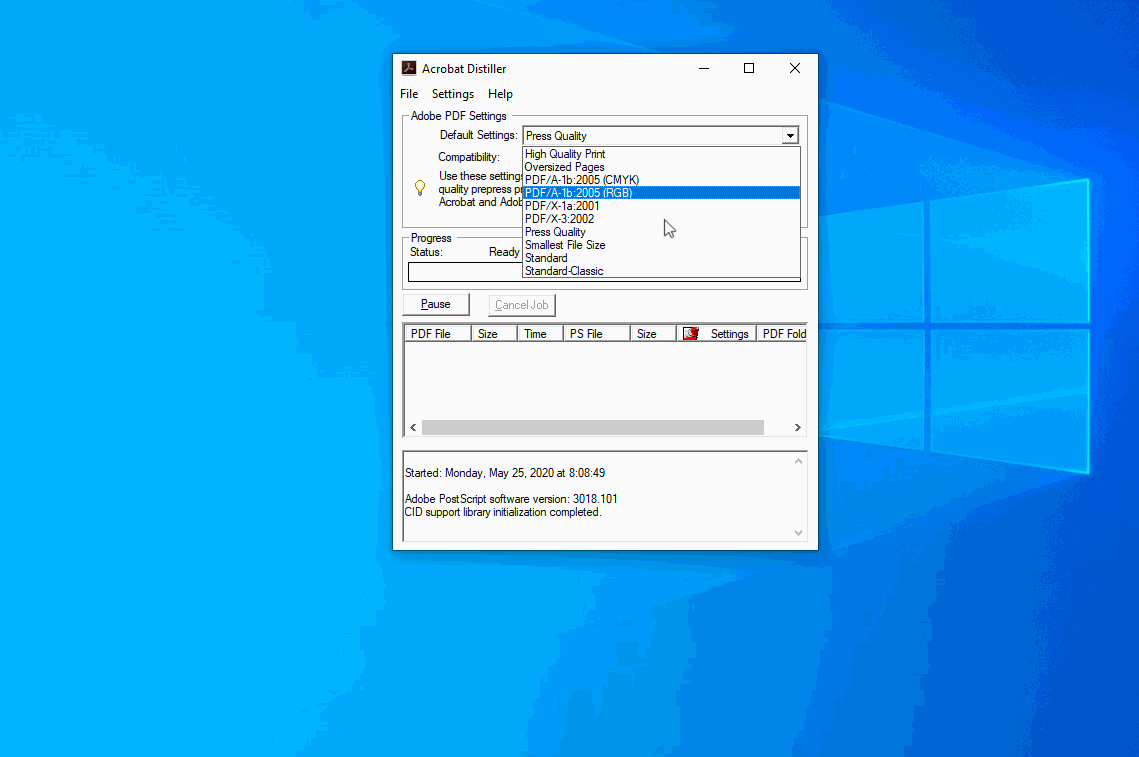

    If you want to keep exploring, open Distiller. It is a separate application that is installed at the same time as Adobe Acrobat and edit either the Standard or the Smallest file size .joboption.
    In my example below, I'm showing you that the list that you see in FrameMaker is controlled by Distiller. I am editing the smallest file size .joboptions file so that it embeds fonts—there are plenty of settings to experiment with—but that's a basic change. Once I save it and return to FrameMaker, that new job option automatically appears in the list.
    That's what Bob is referring to when he says "I normally create uniquely named Job Options for my work, rather than hack the the provided library instances". I do the same thing. That's really the best way to gain control over the export settings.
