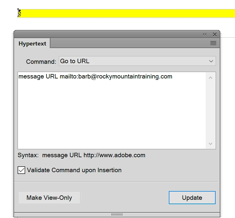

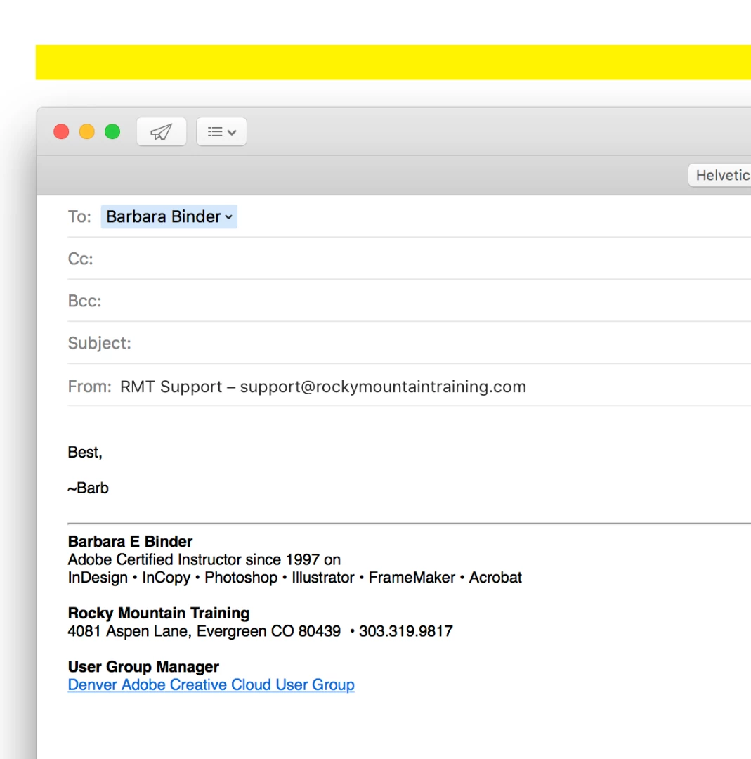

    1. Add a text frame. (If you put the hypertext marker in an otherwise empty frame—the frame boundaries control the clickable area. If you have other text in the footer, the entire footer will be clickable, unless you add the marker into text formatted with a character tag.)
    2. Insert > Hypertext opens the Hypertext pod. (I put the marker into an otherwise-empty frame on the master page, and changed the color to yellow so that you can see it. This means I can click anywhere on the yellow frame in Acrobat to initiate an email.)
    3. Choose Go to URL from the Command menu.
    4. Add mailto:name@companyname.com after the space at the end of the automatically generated text. (Again, the forum is adding the blue symbol after the word "mailto" so look at the dialog box for how this should actually look.)
    5. Click Create.
    6. Save the file, then File > Save as PDF
    7. Click in the appropriate area on the PDF to open up your email client.
    ~Barb

    I had been overwriting the message URL text with the mailto: command (which generated the command error) so I was hopeful the correction would work. Unfortunately the link still opens to the default browser page. My footer has a hypertext link to our web page and it works correctly but the sales@xxx.com link won't work. When I hover my mouse over the link in Acrobat I see the correct command (mailto:sales@xxx.com).
    To troubleshoot Acrobat I highlighted some text in my Acrobat file and created the mailto:sales@xxx.com link and it works as it should.
    I moved my sales@xx.com text from the footer and to the body of the page and the hypertext link works correctly. I decided to move the link within my footer which is on a master page and realized my footer didn't change when I went back to the body pages so I have a different problem.
    The mailto: hypertext command works properly and I discovered I have a master page issue to troubleshoot. At least I have new information to work with.
    Thank you.
