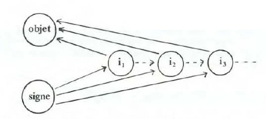

I have scanned a technical book in PDF by using Acrobat Pro.
In the scanned PDF file I have made a screenshot of this graphic :
But inside Frame Maker if I made File/Import/File, the result on the Frame maker document is not good.
What do you advise me to do in order to import graphics from this scanned PDF, with a good quality result inside Frame maker ?

For line art:
1. Scan as line art or black-and-white (phrasing is scanner-software dependent)
2. Scan at 1200-1800 ppi/dpi at 100% scale.
(If you want to double the original size, scan at 2400 ppi., etc. )
3. Save as LZW-compressed TIFF.
Depending on the scanner, it will look as good as the original.

In addition to the other excellent tips so far:
  • That scanned image appears to have some bleed from content on the next page (back of sheet). Obtain some flexible flat black material (such as anti-static wrap) and apply to that back page to drive it all to black.
  • That scan needed to have a transfer function applied for higher contrast (and play with the settings after applying the drive-back-to-black trick).
  • I tend to do such scans at the optimal optical resolution of the scanner, perhaps with the page slightly rotated so that any halftone patterns don't beat against scan lines, creating avoidable artifacts.
  • Then use a raster image editor to rectify, clean up and rescale to optimal workflow resolution. Make sure the image is grayscale, and not color (unless it is color, which introduces myriad other challenges). PNG is adequate for this sort of work.
  • Make sure the FM workflow doesn't down-sample the output further.

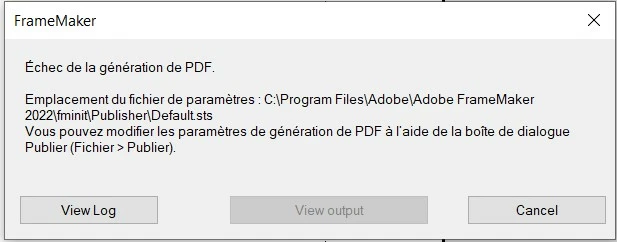

December 21, 2023
In Frame maker I have made Insert/image and selected the TIFF image. So in Frame maker the result in print is OK, but it failed to export the Frame maker document to PDF (error message), and if I do an export to RTF, if I try to open the RTF it opens Microsoft Word but the image has gone in the RTF file. Why ?
Jeff_Coatsworth
December 21, 2023
Not sure RTF supports images - but anyway, what message are you getting when you try to create the PDF with the image in it? What method are you using to create the PDF?
December 21, 2023
In Frame maker, if I try to do File/Save as PDF, I have this error message :
So unable to export to PDF.

December 21, 2023
The screenshot on the scanned PDF file,  is made in jpeg (bitmap image).
I was thinking to another thing : in order to keep quality, do you think I could transform this bitmap image to a vector image, and how to do it with frame maker ?
Matt-Tech Comm Tools
December 21, 2023
Scanning into line art into JPEG is a bad choice, and you can't get back detail that was thrown away in the JPEG compression. Saving as TIFF, per David's suggestion is the better way to go.
Also, there is no great way to produce vector art from poor bitmaps, but you can get amazing results from Illustrator or other software from high quality bitmaps.

December 21, 2023
So the image has gone from a paper image to PDF to a screenshot of the PDF? That sounds like a recipe for a degraded image. If the image isn't available as an image file in the first place, I would go from scanning the paper copy directly to an image file - that's the highest quality you're going to achieve - and then use that image file in your FM content.
