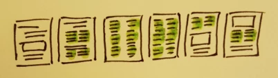

Basically, this is the document structure I want to achieve:
Column sections (in green) that start and end within normal text sections (just like we would do it in Word).

1 chapter divided into 5 sections:
section 1: regular text and graphics
section 2: 2-columns section
section 3: regular text and graphics
section 4: 2-columns section
section 5: regular text and graphics

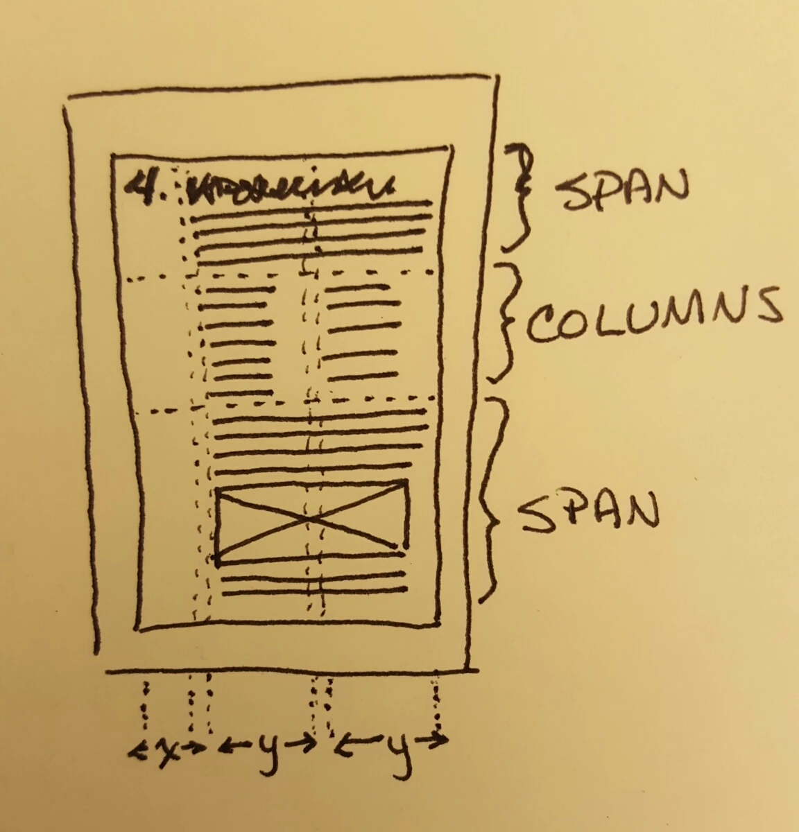

However, the sidehead would not work, since the titles are numbered (ie.: 4. Chapter Title) and appearing as such in the Table of contents.
This is a corporate style used in thousands of our documents. I could not change it.
Spanning all three columns to allow for regular text and titles would have been the perfect solution.
I need to know if it is possible to create Master Pages with columns of different widths (using tools, some sort of programming script...? Anything, really).
Thank you,
Use Across-All-Columns-and-Side-Heads for the titles. Set a tab in the autonumber for Chapter Titles so that the paratext is aligned with the center column left edge.
It does not appear possible to have unbalanced normal FM multi-columns. You can do unbalanced with individual auto-connected text frames on the Master Pages, but then the AAC tricks won't work.

This is what I need to do (without using tables, as some of my columns will spread over many pages and their content will need to be balanced/adjusted automatically, should I add some text in the sections before the columns) :
First of all, is the following possible to create in FrameMaker?
3 columns of different widths : 1st narrower (X) and 2-3, equal in width (Y).
I would create a master page with these 3 columns and span and "un-span" at will, whether I need to use the columns or not.
Note: in my opinion, the first, narrower column is mandatory to allow span to include the section title numbers (always on the left of the text, which is aligned on the left column).
I thank you in advance for any help that you could provide on this.
