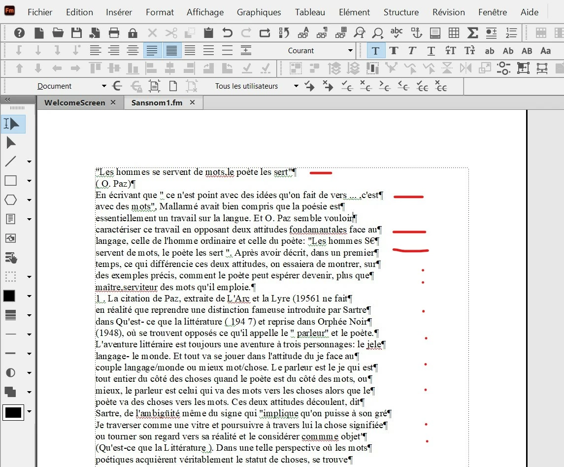

I have copied/pasted text from Word to Frame Maker, and selected "Justify" button in Frame Maker, but I have always some space at the right (see red lines) :
It is strange because I have made a "Paste special" and choosed "Plain Text" in "paste special dialog box".
How to paste without the Word formatting : my goal is to have the text without this space at the right, and make a real justify.

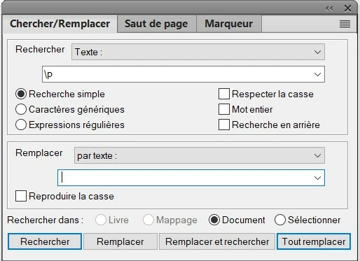

I have succeeded to do it by using search/replace like this :
In fact, the content of my Word file was coming from a PDF file : I had copied and pasted text from the PDF to Word, then from Word to Frame Maker. So all these paragraphs breaks were coming from the PDF. Do you think there is a better way to copy text from PDF and paste it inside Frame Maker without having these paragraphs breaks ?

You're not getting any Word formatting - you've just pasted in plain text - however, as Winfried says, you've got multiple lines with returns in that text, so you need to strip them out or replace with soft returns as he suggests. Right now each of those lines is its own paragraph, so they will respond accordingly when you apply a paragraph tag to them.
Oct 17, 2023 11:50 AM UTC
You have a bunch of separate paragraphs which all have only a single line.
However, to justify a paragraph you need more than a single line.
Therefore you should put everything into a single paragraph.
To do this you can search for \p (that's the pilcrow "character" at the end of a paragraph) and replace it by a space. Or, if you want to keep your line breaks, replace by \r (that's a manual line break).
Generally you should use the paragraph designer and format everything with dedicated paragraph formats.
You should not format something manually. This can get lost.
