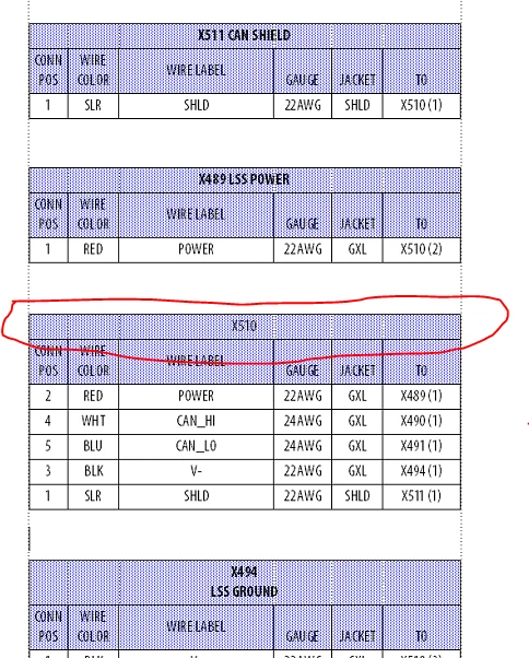

Regarding applying a format to a particular set of text_range. I created a "Character_Format" and i was trying to apply that to my First row content in table. Please see the below code.
if (doc.ObjectValid() ==  true ) {
      var tbl ;
      var textItems = flow.GetText (Constants.FTI_TblAnchor) ;
      for (var i = 0 ; i  < textItems.length ; i += 1 ) {
            tbl = textItems.obj ;
            var row = tbl.FirstRowInTbl ;
            var cell = row.FirstCellInRow ;
            if (cell.ObjectValid()) {
                var cell1 = cell.FirstPgf ;
                var cell_items = cell1.GetText (Constants.FTI_String) ;
                var tr = new TextRange() ;
                tr.beg.obj = cell1 ;
                tr.beg.offset = 0 ;
                tr.end.obj = cell1 ;
                tr.end.offset =  20;
                apply_char_format (tr)
function  apply_char_format(tr) {
var CharFmt = doc.GetNamedCharFmt ("NEW") ;
  if (CharFmt.ObjectValid() == true)
        var props = CharFmt.GetProps() ;
       doc.SetTextProps (tr, props);
       alert("FORMAT APPLIED") ;
The code is  getting executed, but few places  i can see that it didnt got applied to few tables. Please see the image below.
"tr.end.offset" i have given the maximum value. I think there is some mistake i am doing in that highlighted text,Please guide me to solve this issue.

frameexpert
Sep 22, 2017 2:11 PM UTC
Since you want the entire paragraph to be bold, there is no reason to use a character format. Instead, apply a paragraph format that specifies bold to the entire paragraph. This is much easier than applying a character format. Here is a function that will apply a paragraph format to a paragraph.
var doc = app.ActiveDoc;
var pgf = doc.TextSelection.beg.obj; // Paragraph at the insertion point.
var name = "CellHeading";
applyPgfFmt (pgf, name, doc);
function applyPgfFmt (pgf, name, doc) {
    var pgfFmt = 0;
    pgfFmt = doc.GetNamedPgfFmt (name);
    if (pgfFmt.ObjectValid ()) {
        var props = pgfFmt.GetProps ();
        pgf.SetProps(props);
    else {
        pgf.Name = name;
