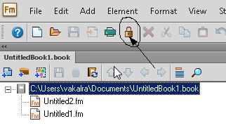

I accidentally made a book file view only. I followed the instructions in the Help, but they don't work. I selected the file in the book view. Then, pressed Esc Shift f l k but nothing happens. The instructions say I should see a menu, but I don't. After pressing the key combination, the book file remains view only.

If you have made the book file view only by mistake, then select that book file, and click on the lock icon to toggle the view only mode.
Thanks.
July 24, 2014
Thanks...that works. I was not showing that toolbar so I was not aware of the lock.
Appreciate your help!

I had no padlock icon and there are no toolbars at all when I open a locked dockument. If I close the document I can make toolbars visible in the View menu (View / Toolbars / Quick Access Bar). This will remain open when I again open the document.
