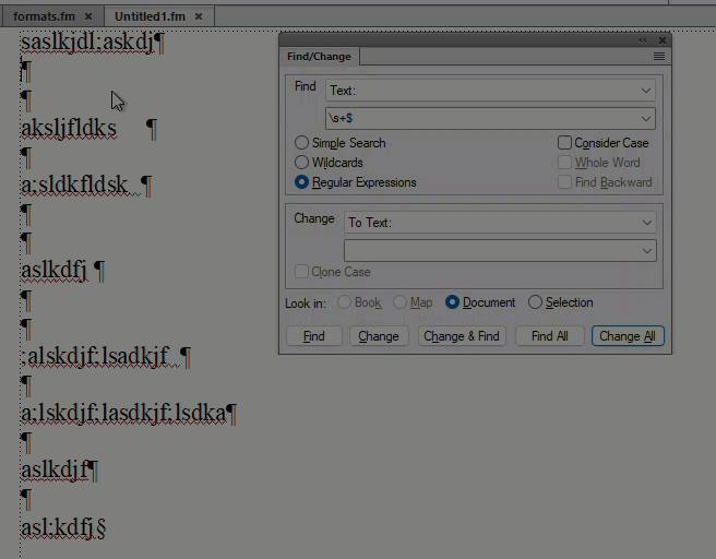

    Hi Pierre:
    I use
    Find: \s+$
    Change: [leave empty]
    Regular expressions on
    I prefer this because it picks up the pesky extra horizontal spaces at the end of the line, in addition to the extra ¶s.

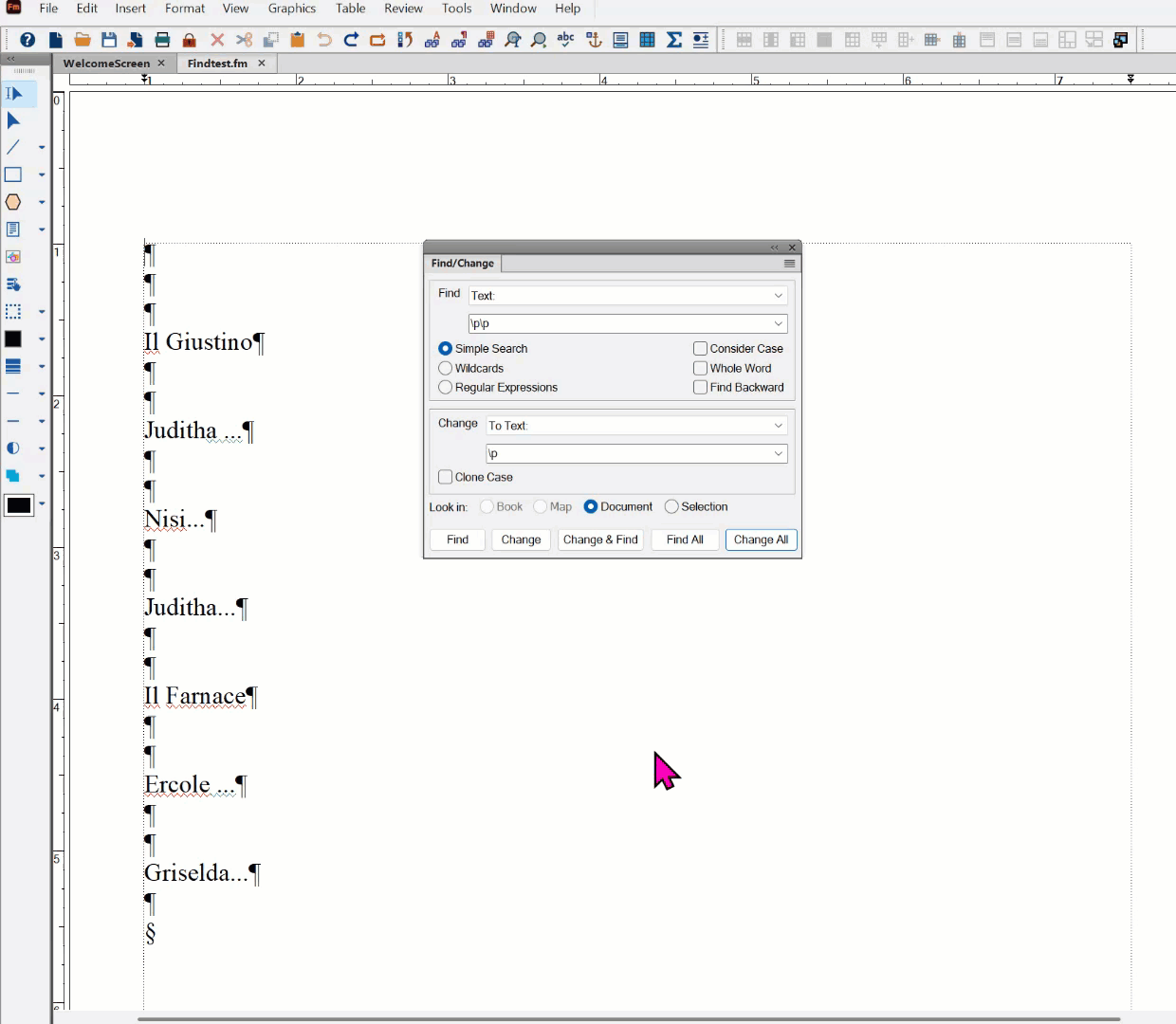

    Aug 30, 2026 12:39 AM UTC
    The first paragraph return will need to be manually deleted.
    Aug 30, 2026 9:57 AM UTC
    ​@Dave Creamer of IDEAS
    Thank you Dave for the video. It helped me how to do.
    I understand that instead of using the “find” button, you use several times the “change all” button. So I have simply used several times the button “change all” and it worked (without doing anything else).

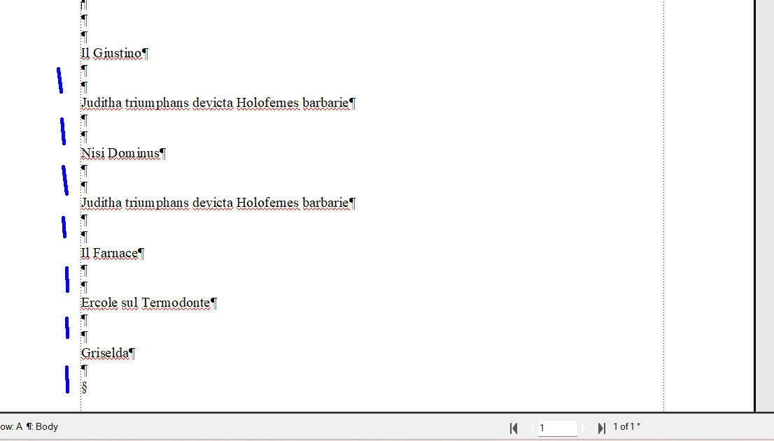

    Aug 29, 2026 3:50 PM UTC
    What exactly is happening? It looks like it selected to paragraph symbols. Did you continually press Change All?
    Aug 29, 2026 3:58 PM UTC
    Here is a video showing the problem : it does not select the 2 paragraph symbols after each line of text.
    Aug 29, 2026 4:15 PM UTC
    You are not pressing the Change All button multiple times.

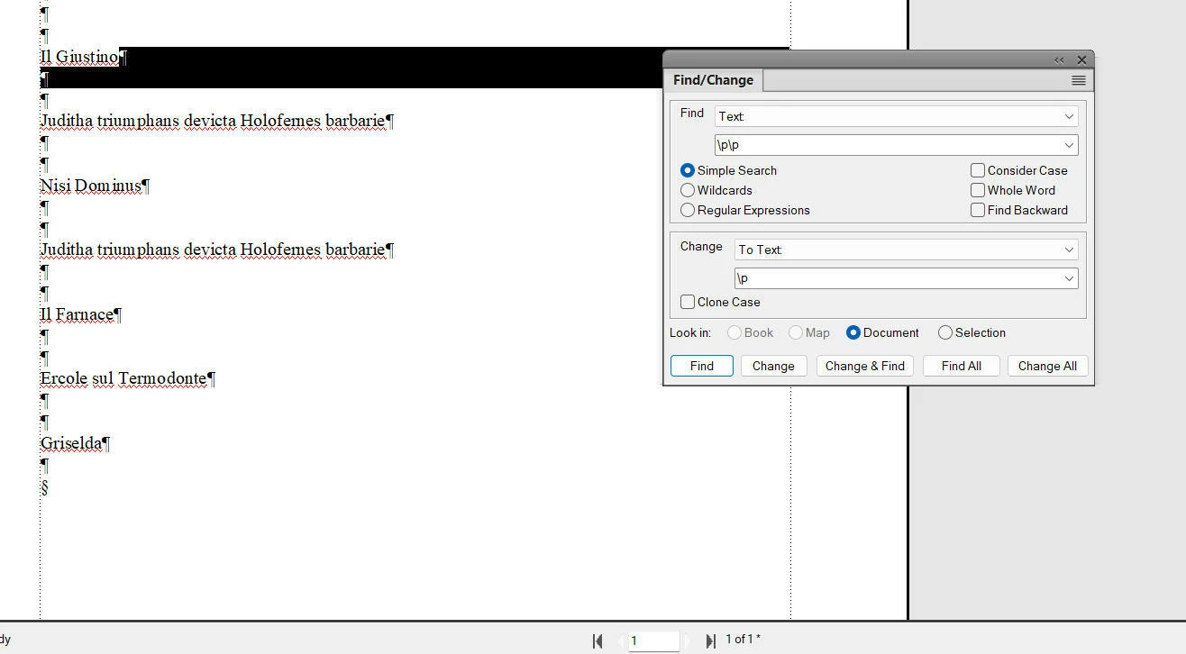

    Aug 29, 2026 2:33 PM UTC
    You can use a regular expression for find/change.
    In GREP, it would be find: \r\r+
    Replace with: \r
    Note: the default in the find regular expression is Perl, not GREP, so it would need to be changed.
    For an easier method, you can use the standard find option.
    Find: \p\p
    Change: \p
    Repeat change all until it can’t find anymore.
    Aug 29, 2026 3:31 PM UTC
    Hi Dave,
    I have just tried to use your second solution (with \p\p), but it does not works. Why ?
