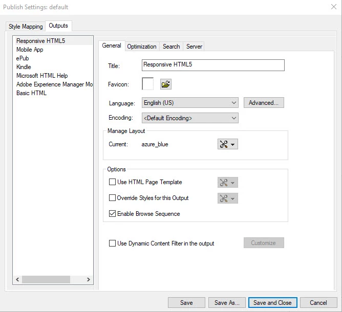

Hezy A
Feb 4, 2020 7:32 AM UTC
Can you check the settings again.
You said you are trying to publish HTML, but the error message you display is from the PDF distiller.
Make sure you selected the correct type of HTML publishing
Feb 4, 2020 3:43 PM UTC
That is why I am a bit stumped. I can publish to HTML for other files in the series/Book. I have no idea why this is trying to open Distiller for this operation and not for the other files. I'm still trying to figure it out, thanks for the reply.

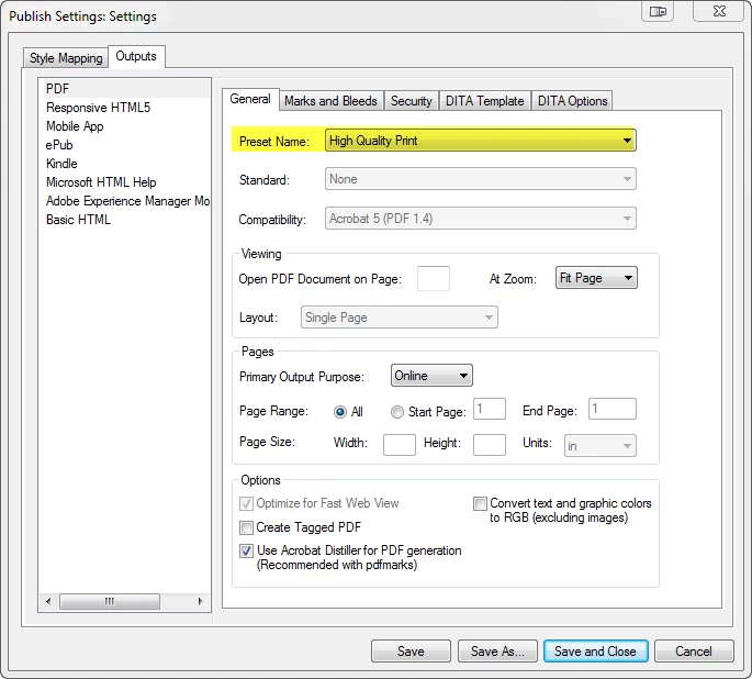

Feb 3, 2020 10:17 PM UTC
Try choosing a different Job Options file:
www.frameexpert.com
Feb 4, 2020 3:41 PM UTC
Thanks for the reply, oddly enough I don't have the PDF settings option in my Job Options menu, but I can create a
PDF, so????
