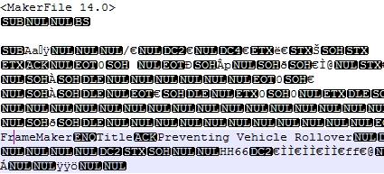

Out of curiosity, I opened the chapter output templates in Notepad++, and I found the title in a few different places, like this:
and this:

It looks like this was coming in from the file info attached to the output template. File > File Info let me delete the unwanted title information.
