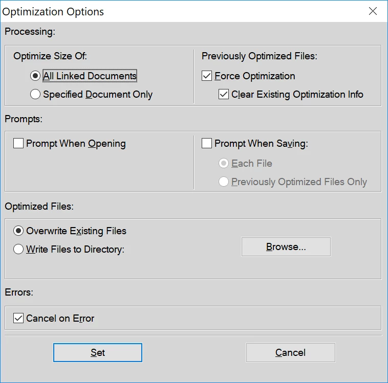

In addition to Tech Comm Tools tips on his page and of course updating to Update 5 for FM 2015:
In FrameMaker, go to > Format > Document > Optimize PDF Size > Options... and set it up like this:
Then, go to > Format > Document > Optimize PDF Size > Optimize File... and run the optimizer on your book or document.
This process reorganizes the objects including Cross-References in your book internally and should solve exactly your problem.

Jan 31, 2018 6:01 AM UTC
Hi Matt, Stefan,
Thank you for providing an answer on such short notice.
However I did update FM, checked the pdf tips and trick page and tried to optimize the book and yet it didn't work.
If you have any other ideas please do not hesitate.
