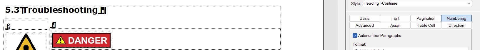

I'm having a problem with chapters starting back at "1"

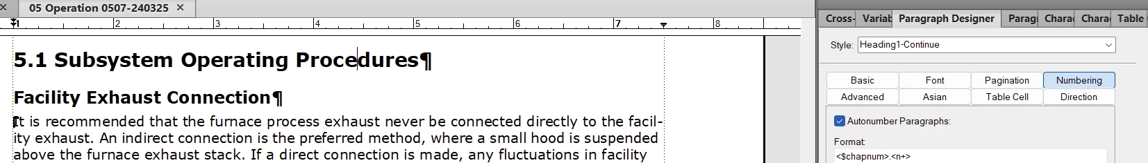

I have a subchapter in a book where the subchapters are numbered. It starts at a subchapter, 5.1, with the paragraph style "Heading 1 Start, and the number properties as <$chapnum>.<n=1> :

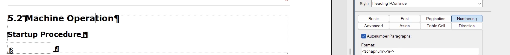

Subsequent subchapters follow the "Heading 1 Continue" style and the number properies as <$chapnum>.<n+> , and it works just fine for 5.2 and 5.3, following the properties for Heading 1 Continue":
But then, when I try to start a new subchapter, 5.4, it only wants to be 5.1, despite having the exact same paragraph style and properties:
 A couple of notes:
1. I have removed all overrides.
2. I am not a programmer. Unless you have text to copy and paste into the code, anything you say will go right over my head 😜.
Thank you.

    Susan and I figured out the problem. There were two separate sets of paragraph formats without series labels (including the heading paragraphs) and they caused the numbers to restart. I showed her how to use series labels to keep numbering paragraphs independent of each other.
    Also, I updated my script to ignore autonumbers without numbering building blocks; for example, bullets and text-only autonumbers. Here is the updated script.

    Hi Susan, You need to set the numbering at the book level instead of the document level. Click on one or more components in the book, right-click and choose Numbering. Set the desired numbering properties there and update the book. Dismiss any "Inconsistent numbering" dialog boxes and you should be all set.

    Bob_Niland
    March 26, 2025
    It appears that you aren't using a Series Label for the numbering.
    This might appear as the H: in a
    Paragaph Format /Numbering\
    Format: [ H:‹$chapnum›.‹n=1› ]
    If the case, various stray numbered paras of other types might be resetting the default counter.
    …which is one reason why the Series Label feature exists.
    Also, check the Numbering properties from the Book menu for each chapter (it's a right-click option), plus within each chapter (Format🞃Document🞂Numbering…), esp. the chapter that's resetting to 1.
